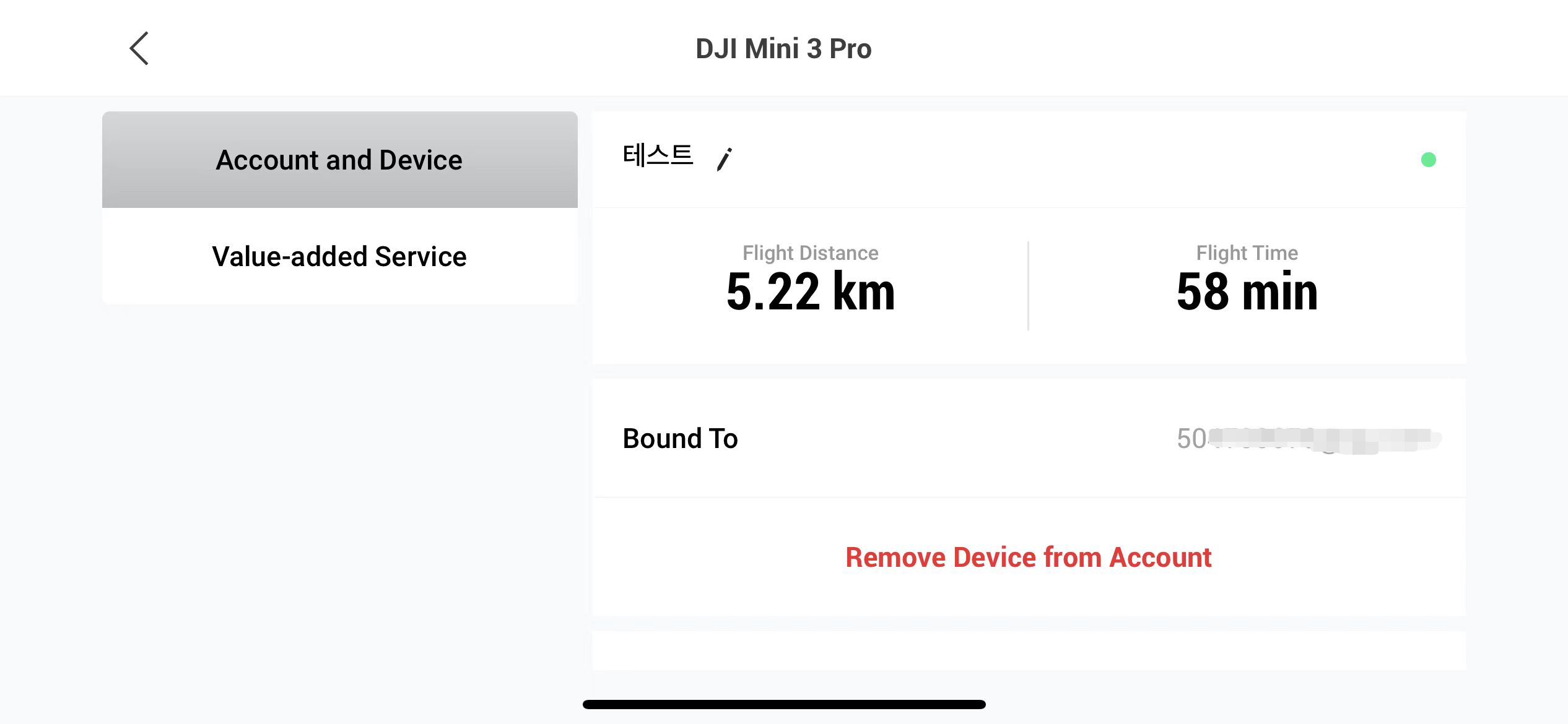

Step 1: Contact the original owner to unbind the drone and the original account.
1. Log in to the DJI Fly app with the original DJI account bound to the drone.
2. Tap [Profile > Device Management > Select Device > Remove Device from Account > Device Unbinding Info > Next].
3. Check the account and drone serial number (SN), and tap “Confirm” to complete unbinding.
❗️ Note: It is recommended that the original owner unbind after confirming the transaction or gift is completed to avoid personal property loss.
Step 2: Once the previous owner has successfully unbound the drone from their account, the new owner can proceed to bind the drone to their account.
1. Log in to the DJI Fly app with a new DJI account, and connect the drone, remote controller, and mobile phone.
3. Check the account and drone serial number (SN), and tap “Confirm” to complete binding.
❗ Note: When binding DJI Avata series or the goggles products, please connect to the mobile device.

How do I check the currently bound account?
1. Check the account bound to a known drone: Tap [Profile > Device Management] to see the bound account.
2. To check the devices associated to a known account, log in to the DJI Fly app and view all devices associated with the account under “Profile > Device Management”.
